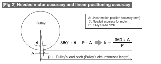

For converting motor rotations to linear motion, accuracies needed for the linear motion mechanism and the drive motor are as follows.
This equation is a conversion of needed linear positioning accuracy and rotational accuracy per 360 degree rotation, easily understandable by the [Fig.2] show below.
![[Fig.2] Needed motor accuracy and linear positioning accuracy](http://www.misumi-techcentral.com/tt/en/lca/images/036_3.gif)
(2) Example
1. If timing belt and pulley selection candidates are as follows...
If linear positioning accuracy A is to be: A = ± 0.1mm...
2. If a ballscrew is used
The accuracy equation above can be used for ballscrew cases by replacing the pulley's lead pitch P with a ballscrew lead pitch.
