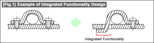

(1) Designing with Integrated Functionalities
The following design thoughts and proceedings are the key.
(1) Giving multiple functions to one mechanical element
Design Points (Hints)
a) Integrated Functionalities concept is often used in mass produced consumer products such as home appliances. Why not give a second look with interests. (See [Fig.1])

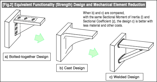

b) Bolted-together Design >> One Piece Cast Design >> Logical cost reduction with the functionality retained, as One Piece Welded Design (See [Fig.2])
