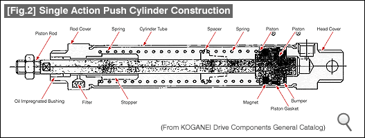

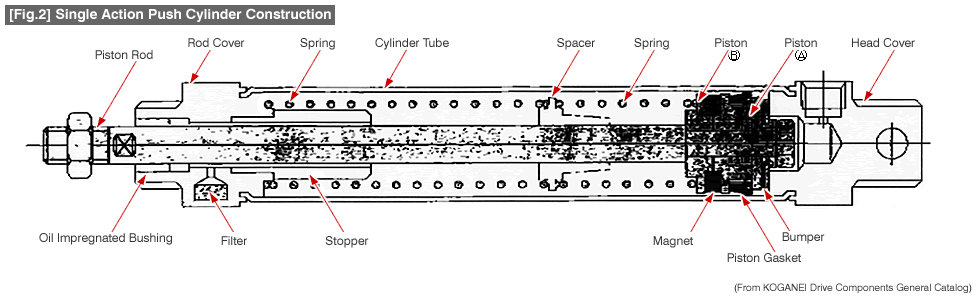

(b)Single Action Cylinders
The value is a sum of dual action cylinder force and the internal spring force (for positive or negative pressure).
Force of Single Action Push Cylinder (See [Fig.2])
Force FPUSH=π/4×(D2・P・μ)−(Spring Return Force)
D:Cylinder Diameter [mm]
![[Fig.2] Single Action Push Cylinder Construction](http://www.misumi-techcentral.com/tt/en/lca/images/068_2.gif)
Force of Single Action Pull Cylinder
Force FPULL=π/4×((D2--d2)・P・μ)−(Spring Return Force)
d: Piston Rod Diameter
