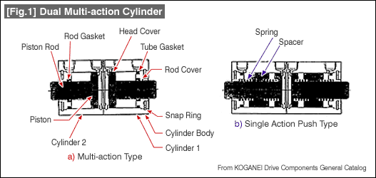

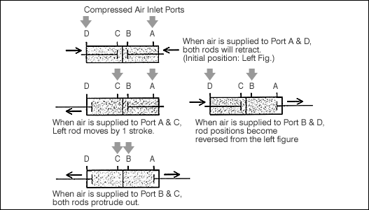

For multi-action cylinders composed of multiple air cylinders, there are Dual Rod Type, Multi-position Type, Dual Type, Lateral Load Resistant Type, and Long Stroke Type. Discussion here will be on force direction control, 2 and 3 step controls with a multi-action cylinder ([Fig.1]) constructed with two back-to-back connected cylinders.
(a) Multi-point Positioning Example with Force Direction Change
The dual multi-action cylinders are typically used where large forces are needed, or space is constrained in radial but not in axial directions.
