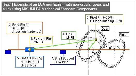

The figure below is an example of motion control LCA. The table below explains the standard component selection.
![[Fig.1] Example of an LCA mechanism with non-circular gears and a link using MISUMI FA Mechanical Standard Components [Fig.1] Example of an LCA mechanism with non-circular gears and a link using MISUMI FA Mechanical Standard Components](http://www.misumi-techcentral.com/tt/en/lca/images/084.gif)
