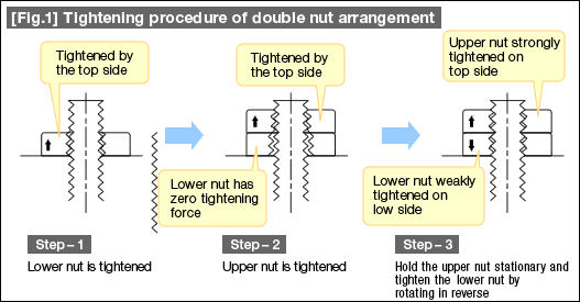

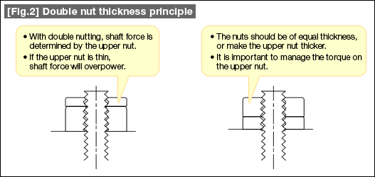

One of the more reliable means to prevent screws from loosening is to use "Double nut" method. There are some fundamental points that must be understood regarding this method. [Fig.1] and [Fig.2] are the fundamental rules with double nutting. If these rules are not observed, seemingly reliable implementation will not yield effective results.
Fundamentals of loosening prevention double nut method
- Effective when the screws may come loose due to rotational force caused by vibrations
- Not effective for loosening caused by material elongation due to material properties.
- Proper procedure is required for double nut tightning. (See [Fig.1])
- The strength of double nut method depends on the strength of the nuts used (principle). Thickness of the two nuts used must be carefully considered.
![[Fig. 1] Tightening procedure of double nut arrangement [Fig. 1] Tightening procedure of double nut arrangement](http://www.misumi-techcentral.com/tt/en/lca/images/108_01.gif)
![[Fig.2] Double nut thickness principle [Fig.2] Double nut thickness principle](http://www.misumi-techcentral.com/tt/en/lca/images/108_02.gif)
