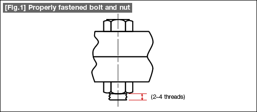

(1) Combination of bolts and nuts
- The fastening strength guarantee values are for usages of bolts and nuts of the same strength classifications used in a normal manner.
- The term "used in a normal manner" means that all the threads of a standard thickness nut are fully engaged with the threads of a bolt ([Fig.1]).
- [Fig.2] shows examples of abnormal usages. The threads of the nuts are not utilized fully.
- [Fig.3] shows examples of excessively long incomplete threads and improper application of shoulder bolts. The subject to be fastened is not properly fastened with bolts and nuts.

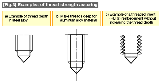

(2) For a bolt and threads
- When bolting a part to a threaded part, the threads must be properly designed depending on the material strength of the threaded part.
Example
- For low strength materials (i.e. aluminum), thread length must be made long in order to ensure ample thread strength.
- If the thread length cannot be made sufficiently long, use threaded inserts (MISUMI: HLTS, etc.) for thread reinforcing.
