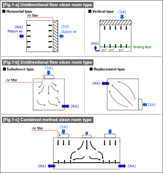

(2) Types of clean rooms
There are following 3 types of clean rooms classified by air flow types (see [Fig.1])

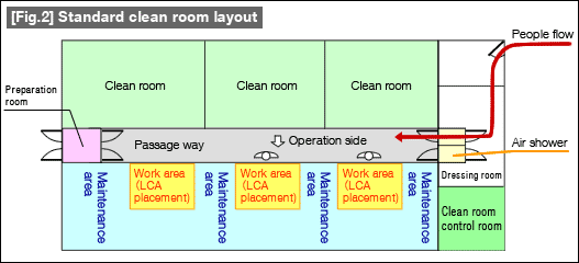

(4) Standard clean room example
[Fig.2] shows an example of a standard clean room. Clean rooms are design to administer proper contamination control for the work to be performed. The cleanliness is made to get higher from the entrance on. The layout is designed according to the types of work (work area, equipment area, maintenance area, passage way, preparation room, etc.).
