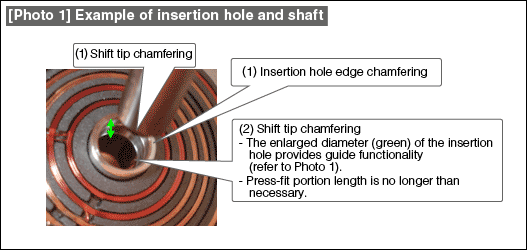

Chamfer (round off, taper) the edges of insertion holes.[Photo 1] (1)
Chamfer edges so that the chamfering is larger than the positional deviation error of the insertion hole.
Use a guide shape (chamfering, reduced shaft diameter) on the tip of the shaft to be inserted as well.[Photo 1] (2)

Ensure that the restriction length for achieving positioning accuracy is no longer than necessary.[Photo 1] (2)

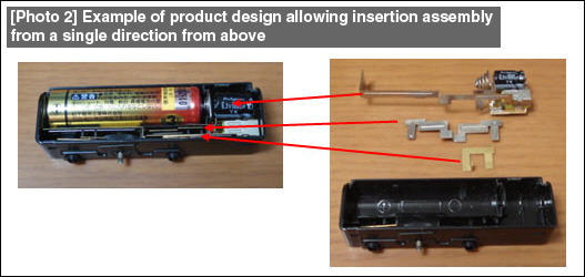

Design products in a way allowing insertion assembly to be performed from a single direction from above.[Photo 2]

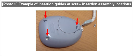

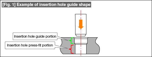

Provide insertion guides for insertion assembly holes and other locations.[Fig. 1], [Photo 3]
[Photo 1] Example of insertion hole and shaft
[Fig. 1] Example of insertion hole guide shape
[Photo 2] Example of product design allowing insertion assembly from a single direction from above
[Photo 3] Example of insertion guides at screw insertion assembly locations
