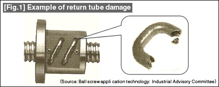

| a) | As the steel ball's orbital speed (dmn value) increases, damages to the ball recirculation circuit components, such as tangs of return tubes, due to repeated shocks will become nonnegligible.![]() |

![[Fig.1] Example of return tube damage [Fig.1] Example of return tube damage](http://www.misumi-techcentral.com/tt/en/lca/images/138_01.gif)
