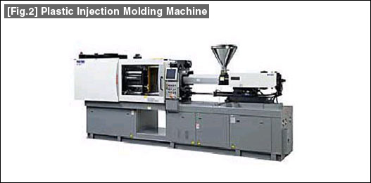

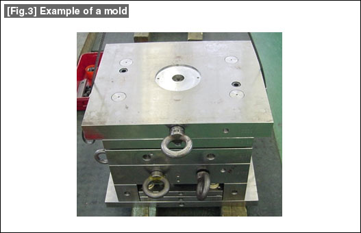

- For the molding processs, a plastic injection molding machine ([Fig.2]) and a mold ([Fig.3]) are used.
