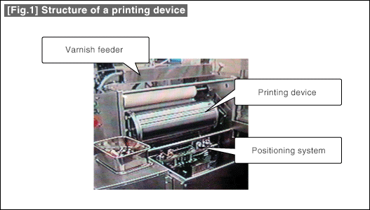

Simplified structure of the sheet fed flexography equipment is as follows.
![[Fig.1] Structure of a printing device [Fig.1] Structure of a printing device](http://www.misumi-techcentral.com/tt/en/lca/images/167_1.gif)
