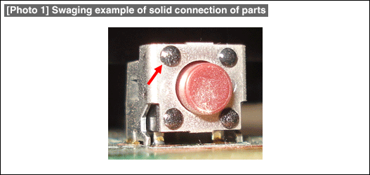

| ・ | The swaging technique is a procedure to permanently fasten parts by deforming the connection points of the parts. |

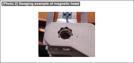

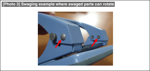

| ・ | Swaged states can be classified in two following types, a) Solid connection of parts [Photo 1] [Photo 2], b) Connection of parts where parts can rotate in relation to each other [Photo 3]. |
![[Photo 1] Swaging example of solid connection of parts [Photo 1] Swaging example of solid connection of parts](http://www.misumi-techcentral.com/tt/en/lca/images/169_1.gif)
![[Photo 2] Swaging example of magnetic head [Photo 2] Swaging example of magnetic head](http://www.misumi-techcentral.com/tt/en/lca/images/169_2.gif)
![[Photo 3] Swaging example where swaged parts can rotate [Photo 3] Swaging example where swaged parts can rotate](http://www.misumi-techcentral.com/tt/en/lca/images/169_3.gif)

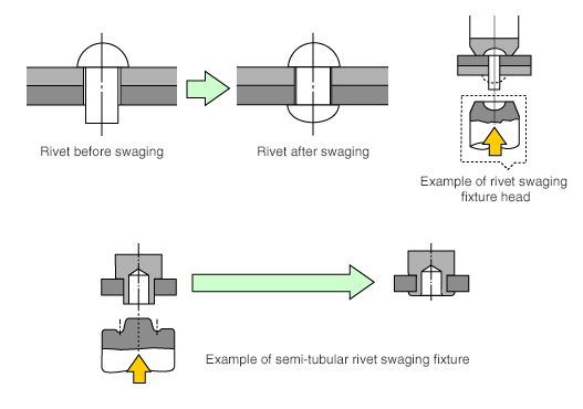

1) Rivet connection
Through holes are made on 2 plate material, and a rivet with smaller O.D. than the hole is inserted and both ends of the rivet are crushed to connect the parts.

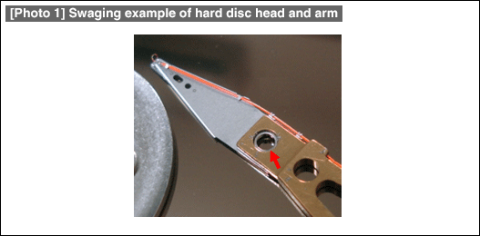

![[Photo 1] Swaging example of hard disc head and arm [Photo 1] Swaging example of hard disc head and arm](http://www.misumi-techcentral.com/tt/en/lca/images/169_5.gif)
Description: Stainless steel head mount rivet is inserted into a hole on a convex/concave formed aluminum arm, then a steel ball is passed through the hole to quickly swage.
