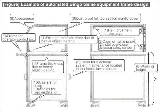

The equipment frame is the structural member that make up the skeleton of the equipment, and the cabinetry is the overall exterior with exterior cover, etc. on the frame. These are important design elements that not only maintain machine performances, but affect appearance and relate to layout efficiency. The drawing process needs to be proceeded with concerns on the following design concepts.
(1) Equipment frame and cabinetry design agenda
- 1. For the automated functions
- 2. Agendas other than automation functionalities
The following agendas exist other than the items regarding automation functionality maintenance described above.
![[Figure] Example of automated Bingo Game equipment frame design [Figure] Example of automated Bingo Game equipment frame design](http://www.misumi-techcentral.com/tt/en/lca/images/186.gif)
