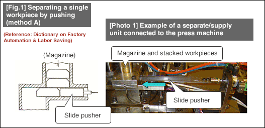

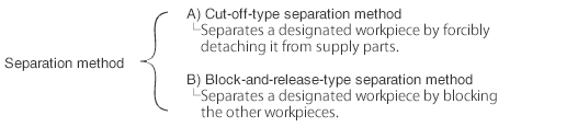

There are following two methods for separation (escapement) mechanism.
This section introduces these methods along with representative examples of the mechanism.
![[Fig.1] Separating a single workpiece by pushing (method A) [Fig.1] Separating a single workpiece by pushing (method A)](http://www.misumi-techcentral.com/tt/en/lca/439_1.gif)

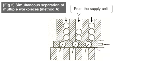

![[Fig.2] Simultaneous separation of multiple workpieces (method A) [Fig.2] Simultaneous separation of multiple workpieces (method A)](http://www.misumi-techcentral.com/tt/en/lca/439_2.gif)
| (Reference: Dictionary on Factory Automation & Labor Saving) |

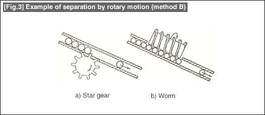

![[Fig.3] Example of separation by rotary motion (method B) [Fig.3] Example of separation by rotary motion (method B)](http://www.misumi-techcentral.com/tt/en/lca/439_3.gif)
