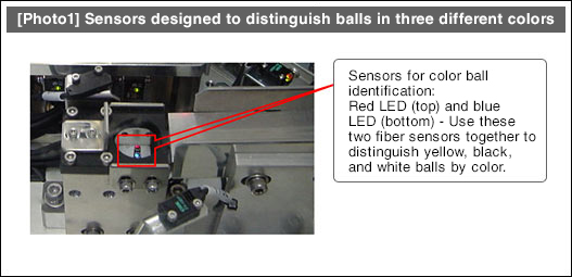

- The Bingo Machine adeptly utilizes fiber sensors emitting homogeneous light so that the balls in three different colors can be identified at low cost.
- In [Photo 1], two fiber sensors are installed for color ball identification.As you can see, the color of the optical fiber cables is different for the two fiber sensors.
- We chose a fiber sensor that uses red LED as the light source (wavelength of 680 nm) along with another fiber sensor that uses blue LED as the light source (wavelength of 470 nm).When you use these LEDs of two different wavelengths to distinguish three different color balls, choose the appropriate sensitivity setting in order to produce light reflection that can distinguish yellow, black, and white color balls.In this way, all you need is two sets of economical sensor/amplifier systems.
