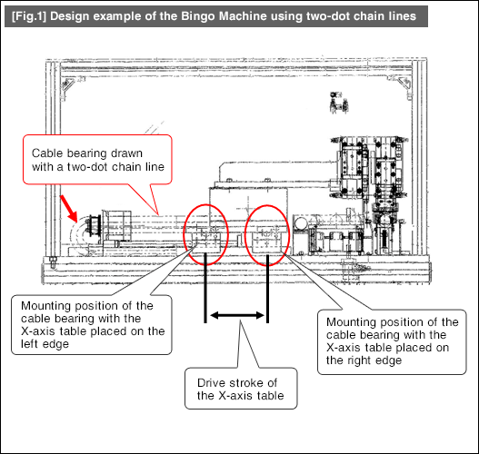

- In the example of the Bingo Machine shown in [Fig.1], two-dot chain lines indicate the cable bearing state at the maximum stroke position of the X-axis table.
- Based on the state of the two-dot chain lines in [Fig.1], you can verify the following:
(1) It is designed with sufficient room that the cable bearing does not touch the cover even when the X-axis table moves to the leftmost position.
(2) In the plan view seen from above (not [Fig.1]), the cable bearing does not get in the way of the manifold regulator of the air cylinder installed on the back.

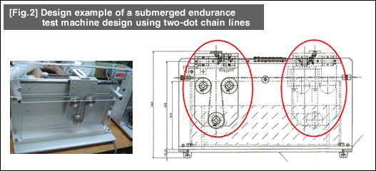

- [Fig.2] is an example of the submerged endurance test machine. The movable body is illustrated at two positions: left end (solid line) and right end (two-dot chain line).
