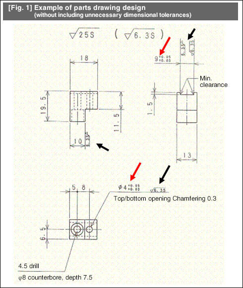

- [Fig.1] shows the drawing of chuck fingers on the hand for transferring color balls. It is necessary to match the position of two chuck units in order to hold spherical color balls steadily by two plane chuck units. For this reason, dimensional tolerances (red arrow) are applied to the positioning groove width.
- A positive dimensional tolerance (red arrow) is applied to holes for the proximity sensor to minimize backlash and allow the parts to fit in the hole.
- Instructions on the finish quality are provided for three areas. While keeping the entire surface rough, a smooth finish is required for the three areas (black arrow).
