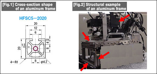

·Because aluminum alloys are suited to continuously manufacturing products in complex shape by extrusion, they are chosen as the base materials of aluminum frames for covers and sashes. In this case, adopt the cross-section shape with the greater secondary factor for the frames to make the structural member lightweight and strong (see [Fig.1]).
·Aluminum is also adopted as structural frames of a worktable for prototype production line or jigs for small-lot production such as for trial or research purposes (see [Fig.2]).
