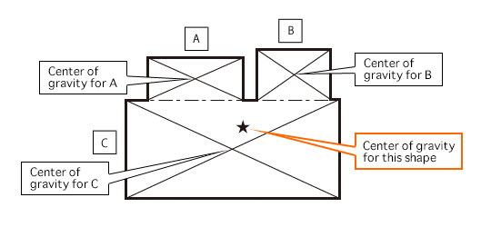

- The center point of a ball will be the center of gravity. The center of gravity for a planar quadrangle is the intersection of diagonal lines. The center of gravity for a triangle is the intersection of median lines.
- For a complex shape, the center of gravity is determined by considering this shape as being made up of several elementary shapes.

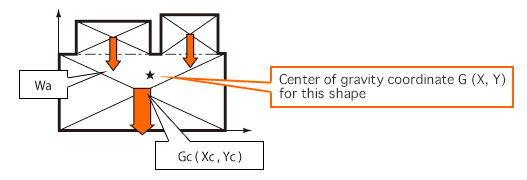

- The figure shown below is an aggregate of three quadrangles (A, B, and C). Each center of gravity is the intersection point of the diagonal lines. Consider that each weight applies to these three centers of gravity. Then, the point of application of their resultant force is the center of gravity.

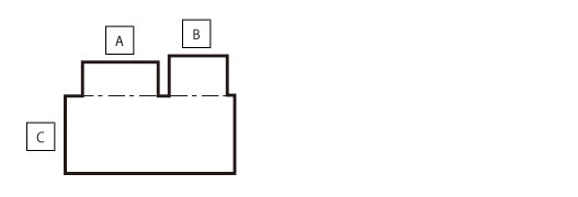

- Split a complex shape into an aggregate of simple shapes. Split it into three quadrangles (see the below figure).

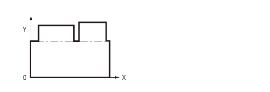

- Define easy-to-understand X-Y orthogonal coordinates for this shape (see the below figure).
- Compute the weight of three quadrangles and name each of them as Wa, Wb, and Wc.
Each center of gravity is expressed as Ga, Gb, and Gc, respectively. Their coordinates are Ga (Xa, Ya), Gb (Xb, Yb), and Gc (Xc, Yc) accordingly.
- The entire weight is expressed as W = Wa + Wb + Wc
- Formula for the moment of force from the coordinate origin O is as follows:
Wa × Xa + Wb × Xb + Wc × Xc = W × X
Wa × Ya + Wb × Yb + Wc × Yc = W × Y
Based on the above two formulas, the center of gravity G (X, Y) will be calculated in the following formulas:
X = (Wa × Xa + Wb × Xb + Wc × Xc) ÷ W
Y = (Wa × Ya + Wb × Yb + Wc × Yc) ÷ W
