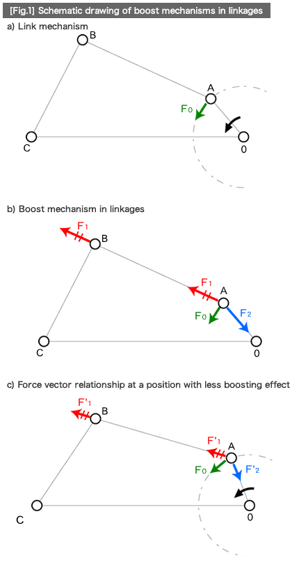

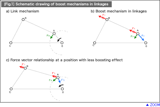

Now, let's take a look at the link mechanism consisting of four-bar linkages in [Fig.1] - a) and consider how the force vector is applied at Joint A.
[Fig.1] - b) is the schematic layout of a link mechanism generating a high degree of boosting effect.
[Fig.1] - c) is the schematic layout of a link mechanism generating little boosting effect.
Let's compare their force vector components at Joint A.
In [Fig.1] - b), "Crank OA" and "Link AB" form an angle of approximately 180 degrees (close to a linear arrangement) whereas "Link AB" and "Lever BC" are almost perpendicular to each other. In this case, if "Torque T" applies to "Driving Shaft OA" and Force F0 applies to the tangential direction of "Joint A", Force F1 applied to "Link AB" on "Joint A" will be 2.7 times greater than the tangential force F'0 based on the vector components at "Joint A".
In [Fig.1] - c) on the other hand, Force F'1 applied to "Link AB" on "Joint A" is only 1.1 times greater than the tangential force F'0.
As seen in this example, using the link mechanism to form the relationship shown in [Fig.1] - b), allows effective construction of the boost mechanism. In addition, when the link mechanism is applied to the boost mechanism, all the rotary couplers (in pairs) and the links must be designed with enforced strength.
