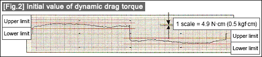

- For ultra-precision ball screws for positioning and high rigidity ball screws for machine tools, the dynamic drag torque is a required inspection item for quality control in the shipping preparation. [Fig.2] is dynamic drag torque data of ultra-precision & high rigidity ball screws for machine tools at factory shipment.
- For quality control at factory shipment, the dynamic drag torques in both directions are measured so that both of them meet the acceptance criteria of preloaded torque. Data in [Fig.2] shows the preloaded torque range between 20.6 and 37.2 N・cm.
