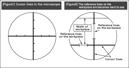

-When the cursor lines in the microscope ([Figure1]) and the reference lines on the workpieces to be set in position are aligned with each other, the reference lines on the workpiece become covered with the cursor lines and thus become invisible, resulting in becomes hard to see the state of positioning ([Figure2]).
![[Figure1] Cursor lines in the microscope[Figure2] The reference lines on the workpiece are becomes hard to see. [Figure1] Cursor lines in the microscope[Figure2] The reference lines on the workpiece are becomes hard to see.](http://www.misumi-techcentral.com/tt/en/lca/502_1.gif)

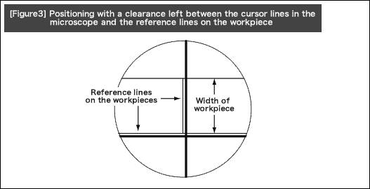

-Then, typically, at a position with a small clearance left between the cursor lines in the microscope and the reference lines on the workpiece which are kept parallel to each other, the positioning is checked for proper state ([Figure3]).
![[Figure3] Positioning with a clearance left between the cursor lines in the microscope and the reference lines on the workpiece [Figure3] Positioning with a clearance left between the cursor lines in the microscope and the reference lines on the workpiece](http://www.misumi-techcentral.com/tt/en/lca/502_2.gif)

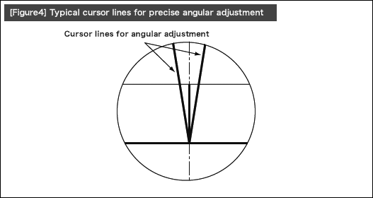

-In practice, however, this method makes it more difficult to identify the state of positioning in case where precise angular adjustment is needed (e.g., positioning of magnetic sensor) ([Figure4]).
![[Figure4] Typical cursor lines for precise angular adjustment [Figure4] Typical cursor lines for precise angular adjustment](http://www.misumi-techcentral.com/tt/en/lca/502_3.gif)

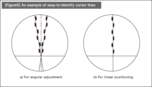

-As a solution to the case shown in [Figure4], improvement in design of cursor lines is recommended ([Figure5]).
![[Figure5] An example of easy-to-identify cursor lines  [Figure5] An example of easy-to-identify cursor lines](http://www.misumi-techcentral.com/tt/en/lca/502_4.gif)
-The design of cursor lines shown in [Figure51 features ease of identification of both linear and angular positioning thus it helps reduce the burden on the eyes in manual positioning under a high-power microscope or through a screen display.
