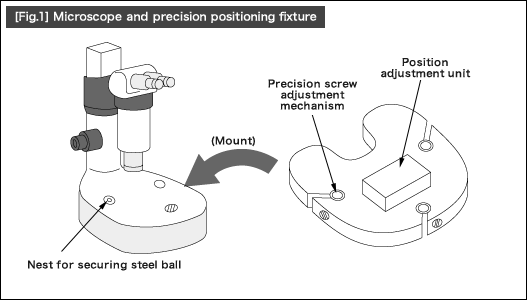

-#288 introduced the precision positioning fixture installed on a microscope for fine-tuning the positions of two components. (Fig.1) In case of multi-model production, setup changes can be done in a short time once a positioning plate designed for each model has been produced.
-In this case, the positioning precision cannot be guaranteed without accurately adjusting the perpendicularity between the microscope's optical axis and the datum surface of the dedicated positioning plate for each model.
-On the dedicated positioning plate, the parallel adjustment mechanism using precision adjustment screws is assembled at three locations. These three adjustment screws allow for adjusting perpendicularity against the microscope's optical axis.

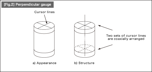

-Fig.2 illustrates a perpendicular gauge used for adjusting the perpendicularity between the microscope's optical axis and the datum surface of a dedicated positioning plate. On this gauge, two pieces of flat glass with cursor lines are placed at a certain distance apart. A virtual line connecting the two origins of the cursor lines is designed perpendicular to the bottom face of this gauge.

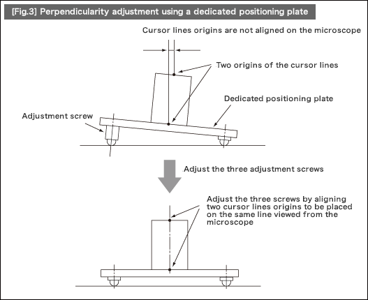

-To adjust the perpendicularity between the microscope's optical axis and the dedicated positioning plate, perform the following: Place this gage on the dedicated positioning plate. Move the Z-axis of the microscope to align the two origins of the cursor lines by adjusting the three screws on the positioning plate. (Fig.3)

-A microscope usually has a heat-generating lighting unit. The microscope unit undergoes thermal deformation while the light is turned ON. After the light is turned OFF, its thermal deformation state changes. Therefore, the best timing of adjusting the perpendicularity of the dedicated positioning plate is when the microscope's thermal deformation becomes stabilized after a certain time has passed since the light was turned ON.
