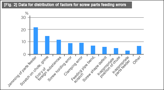

・Fig. 2 shows a typical distribution data representing factors for screw parts feeding errors.Factors causing the problems, based on the data in the figure, can roughly be classified into three categories: (1) feeding mechanism (parts feeder, feeding pipe/chute), (2) screw clamp mechanism, (3) screw parts quality

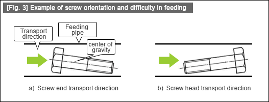

・In the case of Fig. 3-a), the screw orientation during transport and the screw fastening direction after the transport are matched, which requires no inversion of screw orientation. But, this increases a risk that "jamming" may occur in the bending section of the feeding pipe, since the center of gravity is backward against the transport direction.
・In the case of Fig. 3-b), the orientation needs to be reversed before the screw fastening process, although the stability of orientation is good during the transport.
![[Fig. 3] Example of screw orientation and difficulty in feeding [Fig. 3] Example of screw orientation and difficulty in feeding](/tt/en/lca/D544_03.gif)
・Since entry of foreign substances is involved both in the first and the third commonest causes for feeding errors shown in Fig. 2, the countermeasures for avoiding such entry is extremely effective. Following are some examples:
a) Inspection for entry of foreign substances at receiving inspection (automatic selection, etc.)
b) Double selection design during automation process
