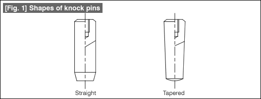

A knock pin can be of the straight type or can be of the tapered type as is shown in Fig. 1.
Each of these come in tapped types also. According to JIS, this is called a dowel pin for press dies (B 5062, only straight type). According to JIS, apart from this, there is a parallel pin (B 1354) and a tapered pin (B 1352) for machines, but their accuracies are far inferior to those of the pins for dies and molds.

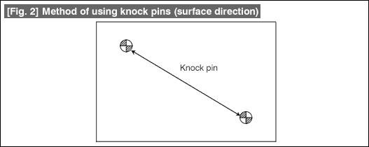

The basic method of using a knock pin is, as shown in Fig. 2, driving in two knock pins in a plate thereby making sure that there is no position shift. For increasing the accuracy, it is better to make their positions as far as possible.

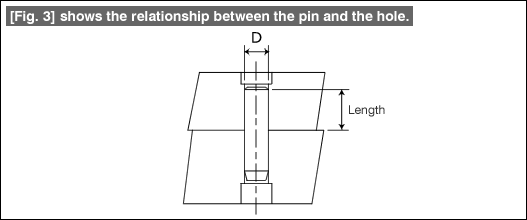

Fig. 3 shows the relationship between the pin and the hole.
A guideline for the relationship between the hole diameter and depth is that the length of the pin retaining part is about twice the diameter, the minimum length being about the same as the diameter, and the maximum being about three times the diameter. If the hole depth is shallower than the pin diameter, the positioning accuracy becomes poor, and if the depth becomes larger than three times the diameter, it becomes difficult to machine the hole while maintaining the accuracy.

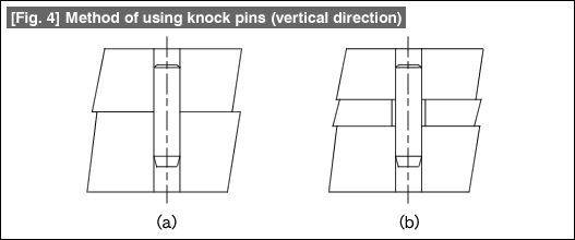

The conventional method of using knock pins is to position two components as shown in Fig. 4(a). However, as shown in Fig. 4(b), although it is possible to use it by passing through three plates, the hole in the middle plate is left free as a dummy hole. Since in this form the middle part of the knock pin is not supported, the accuracy of positioning decreases. Therefore, passing a knock pin through four or more plates should be avoided because of accuracy considerations.
Usually, although the straight type is used more often as the method of using knock pins, the tapered type knock pins is also used. Caution should be exercised because there is the danger of their becoming loose due to vibrations or shock.
