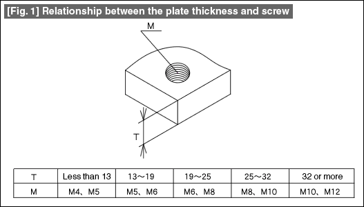

Fig. 1 shows the relationship between the plate thickness and the screw. In general, there is a correlation between the plate thickness and the area, and it is assumed that a plate with an extraordinary large surface area relative to the thickness is not used.
![[Fig. 1] Relationship between the plate thickness and screw [Fig. 1] Relationship between the plate thickness and screw](http://www.misumi-techcentral.com/tt/en/press/images/092_01.gif)

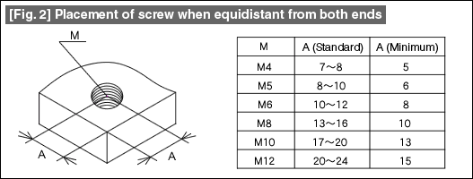

Fig. 2 and Fig. 3 show the dimensions from the end surface of the plate or block taking the screw size as the reference. Assume that the material is steel that is not hardened. For materials such as cast iron which is brittle or hardened steel which can break easily, it is better to use values larger than those of being shown.
![[Fig. 2] Placement of screw when equidistant from both ends [Fig. 2] Placement of screw when equidistant from both ends](http://www.misumi-techcentral.com/tt/en/press/images/092_02.gif)

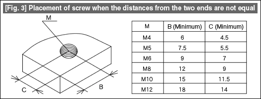

![[Fig. 3] Placement of screw when the distances from the two ends are not equal [Fig. 3] Placement of screw when the distances from the two ends are not equal](http://www.misumi-techcentral.com/tt/en/press/images/092_03.gif)
When block size needs to be minimized, place a screw, used as a stopper and with sufficient strength, at distance equal to the screw diameter from the end surface.
This would be the minimum dimension of screw placement.
