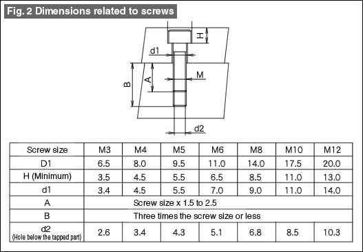

Fig. 2 shows the dimensions related to screws. Although these have been stipulated in JIS also, it is good to decide on your own company's standards. Consider that the following is one such example.
When tapping the holes in the plate, there are the problems of determining the dimensions of the hole below the tapped part and the depth of tapping. When a tapped part that is too deep is specified, the effect is not much but the machining becomes difficult. Determine the hole below the tap and the tap depth that is easy to machine the tap, and make the machining work economical.
