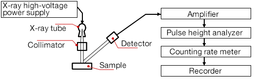

(1)Measurement principle
This is a method of measuring plating thickness using a fluorescence X-ray thickness meter. A test piece is exposed to X-rays emitted from the meter, which detects fluorescence X-rays generated from the plating surface and substrate. This method allows you to measure the thickness of single-layer and multi-layer plating in a short period without destroying the plating film on the metallic or nonmetallic substrate.
(2)Measurement device
Wavelength-dispersive- and energy-dispersive- type fluorescence X-ray thickness meters are available. The energy-dispersive type is more common within the industry because it is easier to operate.
The principle shown in [Fig.] applies to the energy-dispersive type. A proportional counter or a semiconductor detector is used as the detector. The semiconductor detectors are capable of measuring a broader range. However, they have to be cooled with liquid nitrogen at all times.
A collimator is used to narrow the X-ray beam directed into a certain area. This allows the measurement of micro parts of 100 µm or 50 µm in diameter.
