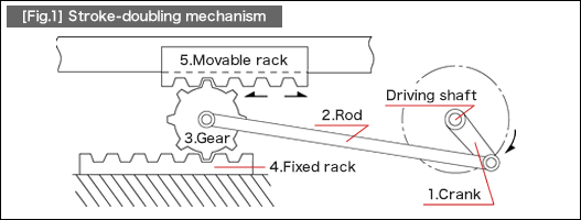

In this volume, we will look at an automation clever mechanism that converts crank rotation into linear motion and makes the linear motion stroke twice that of the original one.
[Fig.1] is a diagram of this mechanism.
fig1
In this structure, the slider used in the standard slider crank mechanism introduced in #251 is replaced by a toothed gear. In addition, the slider guide is separated into a fixed rack and a movable rack. The crank motion on the driving shaft is transmitted to the toothed gear. Then, the stroke of rolling motion (L) over the fixed rack increases by 100% (2L) when it reaches the gear top. This stroke (2L) acts on the movable rack installed on the gear top.

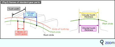

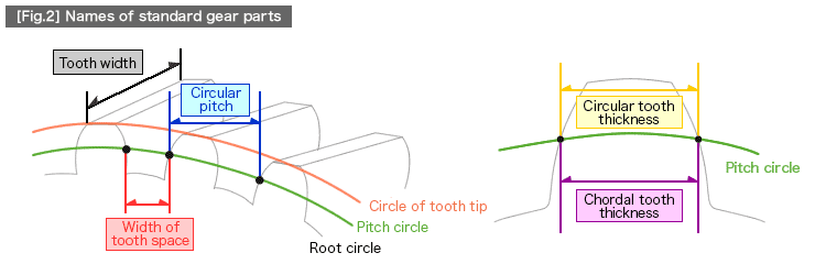

* Additional information (See [Fig.2])
fig2
Module (m): Designation indicating the tooth size of a gear
When (d) represents the pitch circle diameter and (z) represents the number of teeth, the pitch (p) on the pitch circle, called the circular pitch, is calculated by using the following formula:
Circular pitch p = Πd / z
However, the above formula includes an irrational number Π, which is inconvenient for designs using integers. There, the formula with the module (m) is generally used for calculating the size of each tooth.
p / Π = d / z = m
