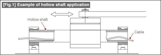

(b)Guiding electrical wire and other plumbing components.
| ・ | Motor cables and air cylinder's air supply can be run through the bore in cases where way covers and other components are obstructing the routes. (See [Fig.1]) |

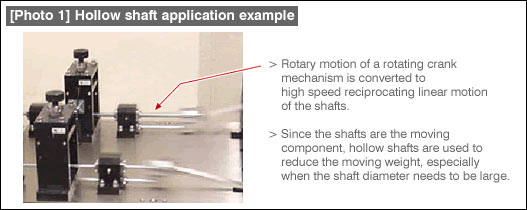

(2)Lighter in weight compared to solid shafts of the same diameter.
For applications where the shafts reciprocate, the weight of the shafts affect the sizing of actuator's prime mover. Cost reduction, energy savings, and motor heat reduction can be gained by keeping the prime mover as small as possible. However, the hollow shafts generate louder noises when subjected to bearing motion, as compared to other shafts in general.
