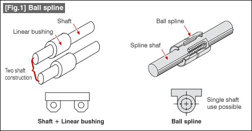

| a) | A ball spline has ball rolling grooves on the shaft, and free to move only in linear direction.
(See [Fig.1])![]() | |

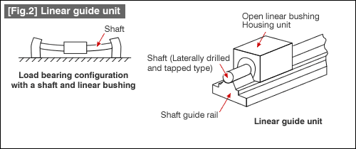

| b) | A guide rail support is provided under the entire length of the shaft, increasing the shaft rigidity. Mating linear bushing has a lower section removed to account for the guide rail. (See [Fig.2])![]() | |

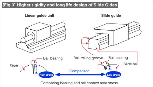

| d) | Principally similar in construction to b), but ball rolling grooves are provided on the rail to increase bearing contact surfaces for high load capability.![]() | |
![Fig.1] Ball spline](http://www.misumi-techcentral.com/tt/en/lca/images/009_02.gif)
![Fig.2] Linear guide unit](http://www.misumi-techcentral.com/tt/en/lca/images/009_03.gif)
![[Fig.3] Higher rigidity and long life design of Slide Gides](http://www.misumi-techcentral.com/tt/en/lca/images/009_04.gif)
