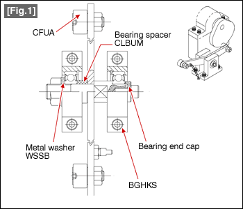

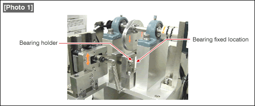

Example (See [Fig.1])
| Here, an axial mounting method of bearings is explained using a linking mechanism with bearings mounted on two T shaped bearing holders. | ![]() |
Three bearing retaining components used are marked with (*) below.
| ・ | A metal washer is used on the tightening nut side of cantilever pin to hold against the inner ring of a radial bearing. | |
| ・ | A bearing spacer is placed between the link arm and a bearing to support the link's rotation motion. | |
| ・ | Bearing in the other bearing holder is fixed to the cantilever pin shaft by it's inner ring with a bearing end cap. |
