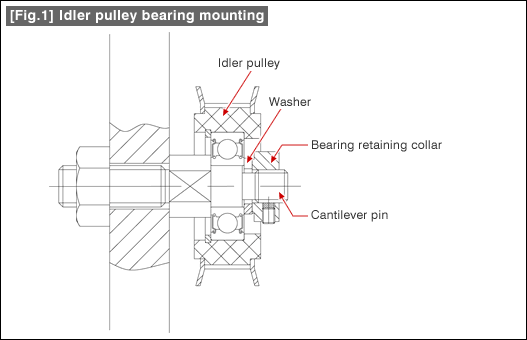

Example 1 (See [Fig.1])
Mounting method for belt tension adjusting idler pulley bearing
![]() | ・ | The idler pulley is mounted with a cantilever pin. This example uses a nut tightened cantilever type. |
![]() | ・ | Bearing retaining collar" is used to fix the idler pulley bearing. |
![]() | ・ | A washer is placed between the bearing and the collar to provide an ample access to the collar's tightening screw. |
![]() | ・ | The washer O.D. should match the O.D. of the bearing's inner ring. |

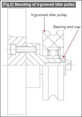

Example 2 (See [Fig.2])
V-groove idler pulley mounting with a bearing end cap.
