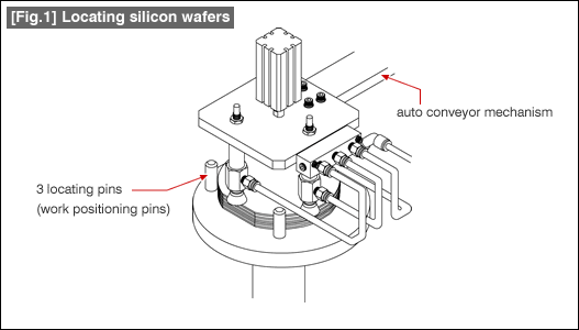

Example - 1: Locating silicon wafers
![[Fig.1] Locating silicon wafers](http://www.misumi-techcentral.com/tt/en/lca/images/014_02.gif)
Characteristics of the work piece
| ・ | Thin disc shape with a partial notch. | |
| ・ | Material is hard, and the disc's side could cause wears on the location pins. | |
| ・ | Used in clean environment and cannot tolerate rust. | |
| ・ | Tips is spherical shaped. | |
| ・ | Tip is spherical shaped. | |
| ・ | Work is located on it's sides. |
In-feed and out-feed method
| ・ | Work is automatically located so only the top side needs to be open for access. |
