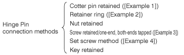

(2) Connecting methods using Hinge Pins.
There are following types.
The Hinge Pins are manufactured with "g6" O.D. tolerance. Mating bores should be made with H7 tolerance to achieve "Slip Fit" connections.
(3) Hints on selecting the connection methods
Evaluate the following check list against the applicable mechanism characteristics to select a proper connection method.
a) The hinge pin and axial force relationship
Hinge pin retaining strength against the axial force would be as follows.
(Low strength) Cotter pin < Retaining ring < Retaining screw < Nut retained < Female thread < Key retained (High strength)
b)Hinge pin replacement frequency
Cotter pins are one-time use only, cannot be reused.
Key retained type is somewhat cumbersome to work on.
Other methods render for easy replacement.
c) An end of the hinge pin can be grasped or not.
If an end of the hinge pin cannot be grasped due to design constraints or there is a width constraints, the retaining screws or the key retained types can be employed.
