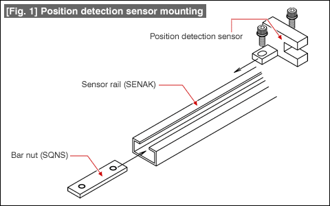

(3) Position detection sensor mounting
![]() | ・ | For a single axis linear motion system, an end-of-travel limit switch at each stroke end, and a home position limit switch will be used. | |||

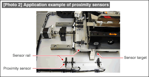

![]() | ・ | [Photo 2] shows an arrangement of position sensors/sensor rails/bar nuts for a 2-axis XY table.![]() |
