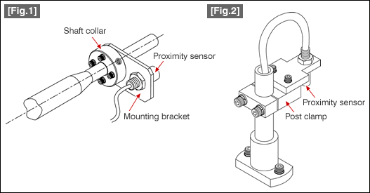

Proximity sensors can be: magnetic (reed switch type), high frequency oscillation, capacitive types. The sensors are offered in a various form factor such as rectangular, cylindrical, through-hole styles, and the popular cylindrical types are threaded on the outer body to facilitate easy adjustments.
Proximity sensor mounting
(1) Characteristics and detection distance of proximity sensors
(2) Cylindrical proximity sensor mounting examples
[Fig.1] shows an example of proximity sensor mounting using a shaft collar (4-hole type) and a mounting bracket.[Fig.2] is an example using a post clamp.
