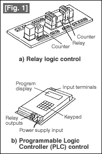

In this third generation, the physically fixed motion control functions of cams/linkages are split apart into "Information" (time and position data) and "Motive power" control. With this, the "hard information" of the cams/linkages are replaced with "soft information" on computer software, and the motive power with servo motor controls, giving the new "Information Cam" scheme greater flexibility needed for a new trend in manufacturing of "Small lot/wide variety". In this period, the control scheme and equipment have rapidly advanced from [see Fig.1] relay logic sequence control >> PLC control >> PC control, requiring drastically increased participation of electric/electronic engineers. | ![]() |
