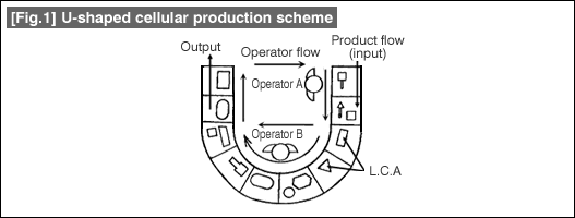

With this background, large scale production facility investments have been suppressed for more efficient investment turnover, and cellular manufacturing concept that enables "small lot / wide variety" is vigorously being considered.
Typical examples of the cellular manufacturing scheme are "U-shaped production line" (see [Fig.1]) and "One-person production" method. These can be characterized by the nature where the operators' capabilities and the hardware capabilities are effectively combined to provide more flexible manufacturing. In order to realize this concept, abilities to quickly self-devise highly efficient production tools (LCA, etc.) to increase the production line efficiency based on the actual field expertise.
![[Fig.1]](http://www.misumi-techcentral.com/tt/en/lca/images/028_1.gif)

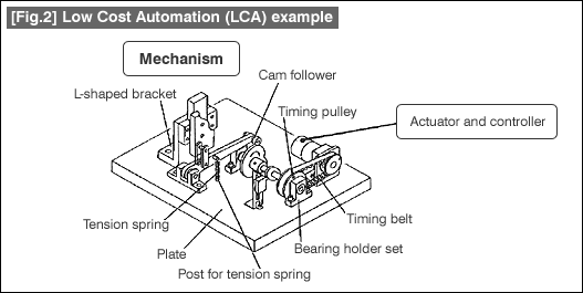

For the previous three sessions, we've discussed the flow of LCA along with the changes in the manufacturing environment. All of the LCA discussed are composed of the fundamental elements shown in the [Fig.2] below.
LCA = Mechanism (mechanical elements) + Actuator (drive element) + Controller (control element)
![[Fig.2]](http://www.misumi-techcentral.com/tt/en/lca/images/028_2.gif)
