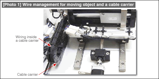

Wiring for machine sections that move at high speeds (upper section of an XY table, linear motor forcer coil, etc.) require special concerns to prevent accidents caused by wire breakage. Additionally, if the moving part carries additional devices such as air cylinders and linear encoders for position measurements all the cables must be handles properly so they do not hinder the movement. To do this, a cable carrier is typically used to manage the wiring to the moving body.
![[Photo 1]](http://www.misumi-techcentral.com/tt/en/lca/images/043_1.gif)
While the cable carriers offer increased reliability for moving wirings, it has its own moving deformation resistance that may negatively affect the motion accuracy of the system. Following points are to be considered.

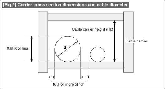

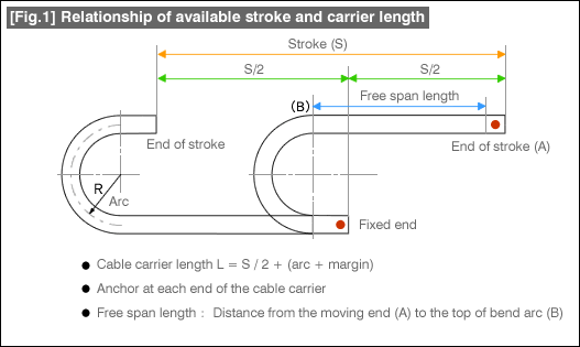

(1) How to use a cable carrier
![[Fig.1]](http://www.misumi-techcentral.com/tt/en/lca/images/043_2.gif)
![[Fig.2]](http://www.misumi-techcentral.com/tt/en/lca/images/043_3.gif)
