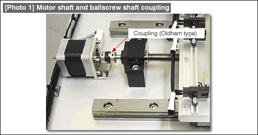

Components used to transmit motor's torque (force) and rotation (moving distance) to a ballscrew may largely affect the system accuracy, reliability, and ease of assembly. Couplings are explained in this tutorial.
(1) Role of couplings
When connecting both shafts of a motor and a ballscrew, the arrangement may be accurate statically but can include possible variables dynamically, as show below.
| 1. | Ballscrew shaft deflection when rotating. | |
| 2. | Shaft deformation and stress due to heat expansion. | |
| 3. | Deformation of ballscrew support unit. | |
| 4. | Friction resistance variances due to bearing wear, after extended usage. |
Therefore, couplings that can solve the variables from issues 1~4, instead of using a rigid body to connect the two shafts.
(2) Coupling types, construction, and characteristics
![[Photo 1]](http://www.misumi-techcentral.com/tt/en/lca/images/044.gif)
