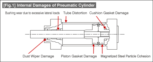

Excessive lateral loads on piston rodsExcessive lateral loads on piston rods causing air leaks from piston gaskets, rendering the cylinder unusable. (see [Fig.1])
1. Design with no lateral loading
2. Reevaluation of cylinder mounting methods
3. Use of Long Rod/Long Bushing type to give lateral load immunity

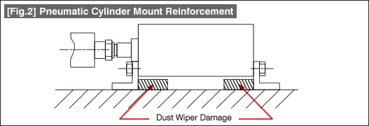

Insufficient rigidity of mounting baseInsufficient rigid mounting base may suffer damages from shocks caused by load velocity dynamics
1. Reinforced mounting base design (see [Fig.2])

[Fig.1] Internal Damages of Pneumatic Cylinder
[Fig.2] Pneumatic Cylinder Mount Reinforcement
