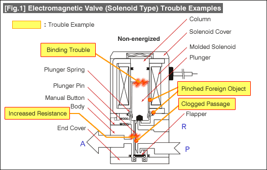

![[Fig.1] Electromagnetic Valve (Solenoid Type) Trouble Examples](http://www.misumi-techcentral.com/tt/en/lca/images/065_1.gif)

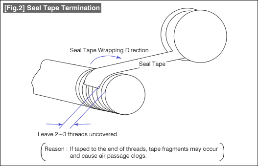

![[Fig.2] Seal Tape Termination](http://www.misumi-techcentral.com/tt/en/lca/images/065_2.gif)
