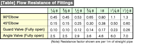

| 4. | Select connection fittings with consideration for air flow resistances (see [Table]) | |

![[Table] Flow Resistance of Fittings](http://www.misumi-techcentral.com/tt/en/lca/images/073.gif)
