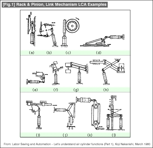

(1) Rack & Pinion, Link Mechanism LCA Examples (see [Fig.1])

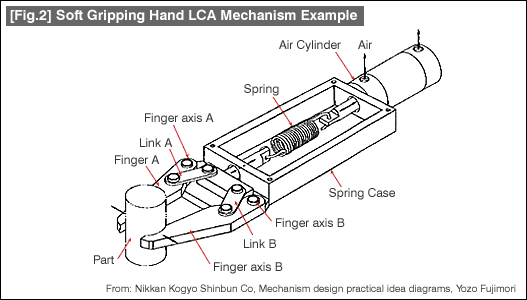

(2) Soft Gripping Hand LCA Mechanism Example (see [Fig.2])

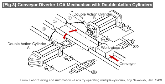

(3) Conveyor Diverter LCA Mechanism with Double Action Cylinders (see [Fig.3])
