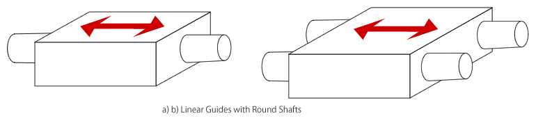

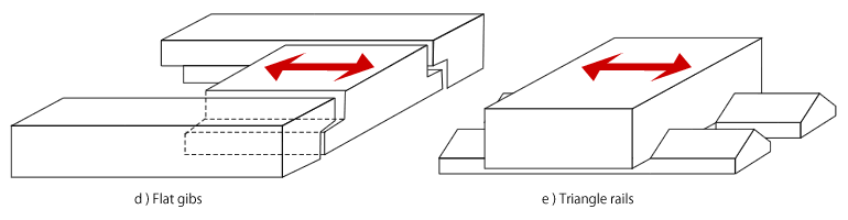

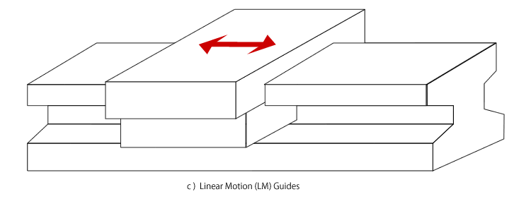

(1) Linear Sliding Guides
Linear sliding guide is a mechanism allowing linear movements with accuracy and with little friction of linear motion units such as air cylinder driven units.
