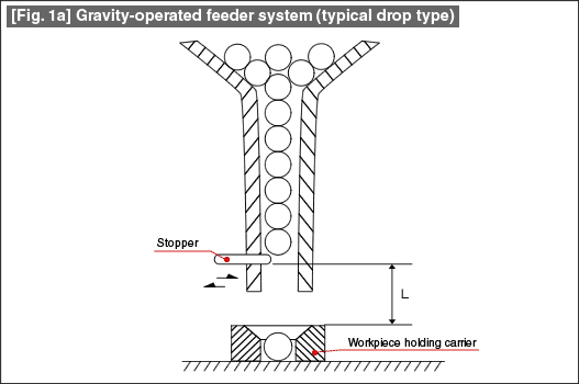

(1) Drop type
The distance (L) from storage hopper to workpiece holding carrier and the time (t) required for workpiece feeding can be determined using the following formula (See Fig. 1a):
t = √2L/g
g : Gravitational acceleration (mm/s2)
![[Fig. 1a] Gravity-operated feeder system (typical drop type) [Fig. 1a] Gravity-operated feeder system (typical drop type)](http://www.misumi-techcentral.com/tt/en/lca/images/087_02.gif)
The orientation of the workpiece can be kept unchanged while dropping using the characteristics of the shape of each workpiece and the position of the center of gravity.

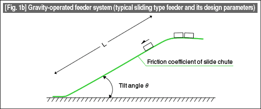

(2) Sliding type
The feeding speed can be controlled using two design parameters: angle (θ) and friction coefficient (μ) of the slide chute (See Fig. 1b):
![[Fig. 1b] Gravity-operated feeder system (typical sliding type feeder and its design parameters) [Fig. 1b] Gravity-operated feeder system (typical sliding type feeder and its design parameters)](http://www.misumi-techcentral.com/tt/en/lca/images/087_03.gif)
The friction coefficient (μ) is adjustable to some degree using the contact area of the transferred workpiece with the sliding surface. Therefore, the sliding speed can be controlled via the chute sliding surface, which may consist of, e.g., punched plates. The time t required for feeding can be determined using the following formula:
t=√{2L/g (sinθ - μcosθ )}
L : Length of straight section of slide chute (mm)
θ : Tilt angle
μ : Friction coefficient
(Mild steel : 0.40, cast iron : 0.20, aluminum : 0.36)
If equipped with a vibrational parts feeder, a sliding type feeder system is capable of aligned feeding of workpieces with complicated shapes. This section assumes the use of simplistic jigs, such as auxiliary jigs, for use in one-piece flow production lines.
