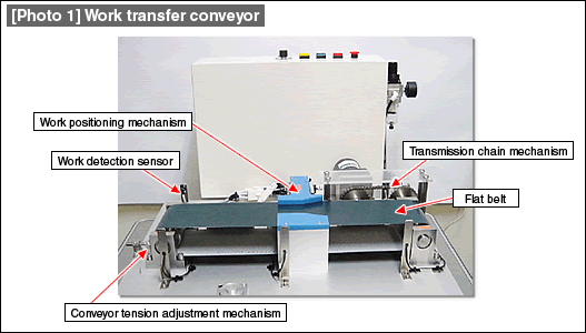

A work transfer conveyor (Photo 1) with an auto-pause function for three stations is discussed here as an example of LCA mechanism design. A perspective view of this LCA mechanism is second from the right, bottom row in "Typical Applications of Standard Components: 1" on the center-page spread of the "FACE-FA Mechanical Standard Components Catalog."

(1) Main components of the work transfer conveyor
This simplified automated system (LCA) for positioning and transferring incoming workpieces on a conveyor can be used as an auxiliary system for a series of operations including, for example, feeding, positioning/inspection, and pre-ejection pauses. The components of this system are as follows:
- Flat belt driven mechanism and belt tension adjustment mechanism
- Motor torque transmission chain mechanism
- Work positioning mechanism
- Work detecting and drive controlling sensor system
