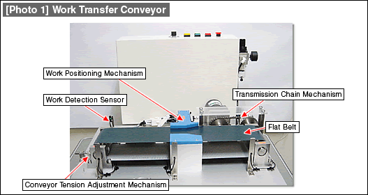

(1) Overview of Work Transfer Conveyor Belt Holding Mechanism
The tension of the flat belt is generated by the tensile force from the two barrel-like flat belt pulleys held by bearing holder sets pulled toward both ends (see Photo 1). The design of the mechanism in which tension is placed on the flat belt (conveyor) when the two flat belt pulleys are in parallel is a feature of the conveyor belt tension adjustment mechanism.
![[Photo 1] Work Transfer Conveyor [Photo 1] Work Transfer Conveyor](http://www.misumi-techcentral.com/tt/en/lca/images/089_01.gif)

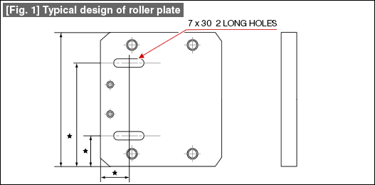

(3) Design of Roller Plate
A reference drawing of a part other than standard parts is shown in Fig. 1.
![[Fig. 1] Typical design of roller plate [Fig. 1] Typical design of roller plate](http://www.misumi-techcentral.com/tt/en/lca/images/089_03.gif)
Easy adjustment and maintenance of the assembly are thanks to this construction along with adoption of standard parts for cost reduction.
